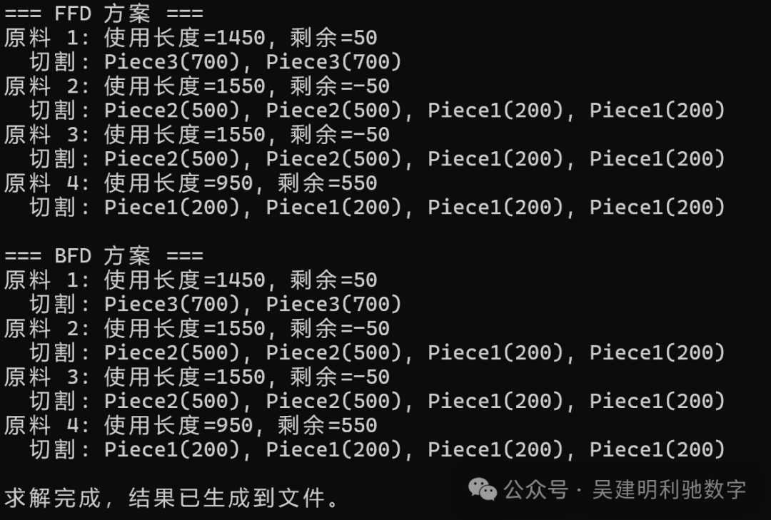

FFD 算法实现
public static List<Stock> SolveFFD(Job job)
    var sizes = job.TargetSizes
                   .SelectMany(s => Enumerable.Repeat(s, s.Quantity))
                   .OrderByDescending(s => s.Length)
                   .ToList();
    List<Stock> stocks = new List<Stock>();
    foreach (var item in sizes)
        bool placed = false;
        foreach (var stock in stocks)
            if (stock.RemainingLength >= item.Length)
                stock.Cuts.Add(item);
                placed = true;
                break;
        if (!placed)
            stocks.Add(new Stock
                MaxLength = job.MaxLength,
                CutWidth = job.CutWidth,
                Cuts = new List<JobItem> { item }
    return stocks;
BFD 算法实现
public static List<Stock> SolveBFD(Job job)
                   .ToList();
        Stock bestStock = null;
        int minRem = int.MaxValue;
            if (stock.RemainingLength >= item.Length && stock.RemainingLength - item.Length < minRem)
                minRem = stock.RemainingLength - item.Length;
                bestStock = stock;
        if (bestStock != null)
            bestStock.Cuts.Add(item);
        else
    return stocks;

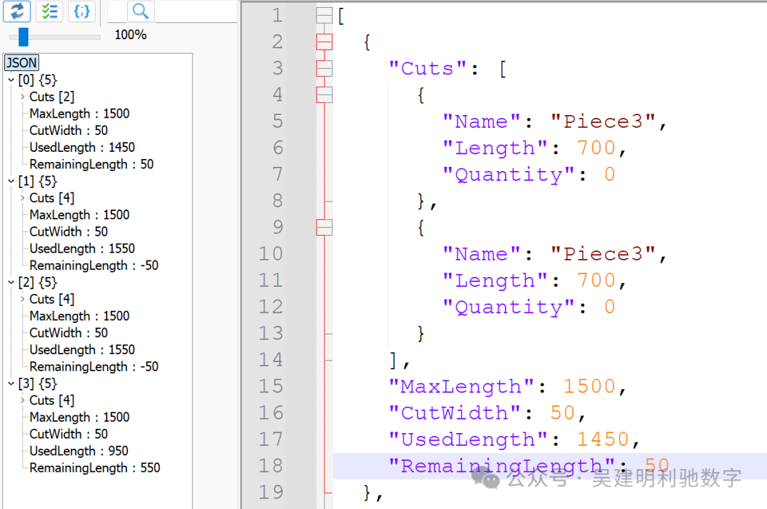

文件驱动主程序
using System.Text.Json;
class Program
    static void Main()
        string inputPath = "job.json";
        string outputFFD = "output_ffd.json";
        string outputBFD = "output_bfd.json";
        Job job = JsonSerializer.Deserialize<Job>(File.ReadAllText(inputPath));
        var ffdStocks = SolveFFD(job);
        var bfdStocks = SolveBFD(job);
        File.WriteAllText(outputFFD, JsonSerializer.Serialize(ffdStocks, new JsonSerializerOptions { WriteIndented = true }));
        File.WriteAllText(outputBFD, JsonSerializer.Serialize(bfdStocks, new JsonSerializerOptions { WriteIndented = true }));
        Console.WriteLine("FFD 和 BFD 求解完成,输出已生成。");
输入示例 (job.json)
  "MaxLength":1500,
  "CutWidth":50,
  "TargetSizes":[
    {"Name":"片段1","Length":200,"Quantity":8},
    {"Name":"片段2","Length":500,"Quantity":4},
    {"Name":"片段3","Length":700,"Quantity":2}
输出
